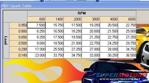

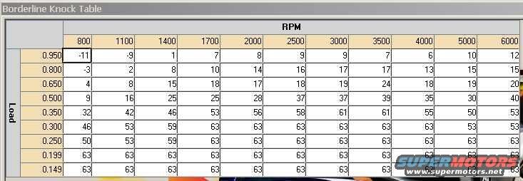

Can I see some screen shots of base spark table and MBT spark table, and maybe a few other modifier tables. I have no stock table information available to me. It would be very benefical to see some tables so I can get a idea whats left on the table in the stock program. I feel the stock modifiers have convinced me that this car has dual personalities like Dr Jekyll and Mr Hyde. Sometimes WOT are amazing and others lacking....
I believe the stock program is soft on the timing on the bottom end, obviouslly runs pig rich on the top end, and not sure if timing disapears at redline....
Be interesting to know...

Have you been paying attention to engine timing and ECT data logging? I made some good pulls earlier today with engine temps around 190 degree F. Looks like the PCM was calling for max timing the whole way and car felt strong. However a later pull starting out at engine temps of 200 degree F and lots of timing flux by the PCM. Looks like I was riding the knock sensor through the pull.
I am thinking a change in thermostat temp might be in order.
