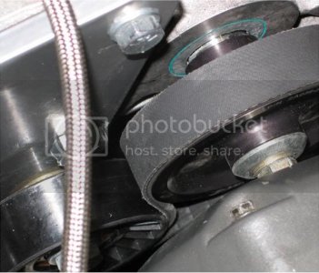

The bracket isn't the only part of the equation. The SC pulley and idler pulley also come into play. My Reichard pulley is a little off from what the Vortech one was at. I've seen my fair share of SS brackets and I haven't seen any reason to question those.

When I say "brackets worked over" I mean pullies aligned properly and other tweaking. Some people change their location of the idler pulley to help decrease/eliminate belt slip with higher psi setups. I'm sure this is nothing new.

you're preaching to the choir, I'll let you guess whose cardomain I took this off of.

The 94-95 brackets present a challenge as the extra mounting post interferes with the original idler pulley mounting location. These brackets just need the pulley mounted in a different location to get maximum belt wrap. It gets tricky as if you look at the picture above, the belt coming back around the back side of the SC pulley is only a couple mm away from touching the belt coming off the idler pulley. Boost/pulley size can play a major factor when looking to relocate the idler pulley.
What I did above was drill and tap threads in the bracket itself. I cannot get anymore belt wrap withough having the belt touch itself.
