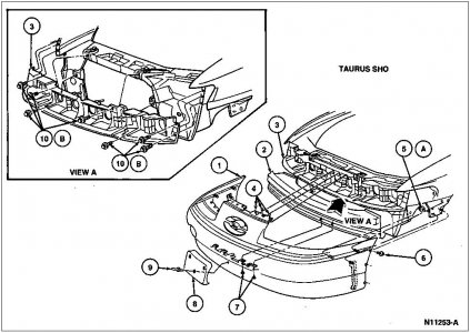

here is the diagram I got from the 1995 ford CD.
SHOfrontend
OTMH, there are 4 bolts and 14 push fasteners to remove the front bumper cover. I'd start by removing the bumper and inspecting for any underlying damage.

I've just repaired the front bumper on my 93. The parts invloved are 1) Fascia, 2) header (holds the light assemblies and anchor point for the top of the fascia) and 3) bumper the thingthat takes the hit.
The bumper is mounted to the front clip with a couple of shock absorbers. Three bolts going into the car and three going into the bumper. When you hit something the bumper usually jams these mounts into the sheet metel and deforms it some.
What happened to your car to cause this gap, surely you didn't come out one day and just notice a 6" gap all of a sudden?
Once you get these parts positioned and mounted correctly wrap the fascia back aroung everything and snap in a few new plastic buttons to hold it on and your done.
Sounds like you took a hit and will have to dismantle all this stuff, find out where the damage is, replace what can't be salvaged and reassemble. That is what I did and after all was back in place the fascia, while it didn't fit perfectly, fit lots better than before.
Or of course you could simply look at the image above for all these answers.

As I have just removed mine front end for the core support pull... I couldn't for the life of me figure out where you could have THAT much sag... Are the push pins there on the upper side of the lower opening(#7 in pic)? On top of the b/c where the hoodlatch is(#4 in pic)? Thats the only kind of part I can think of pulling anything down. Either that or your bumper itself is busted...

If you do pull the b/c... AZ has a pack of 15 of those plastic plugs (#4 & #7)that you most certainly will break a few. Ask me how I know. It was around $3. They dont seem to have the huge "Help!" section anymore, just some stuff. I liked this better, This section has alot of specific fastenters with better prices and larger quantities for the $. They also have those reuseable plastic rivets with the philips screw head for the same price.
