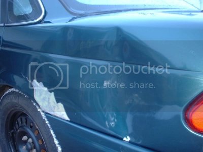

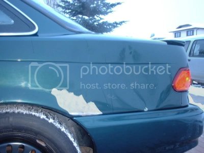

I am in the same boat, but a recent road trip has added to my problem. I now have rusty quarters, AS WELL AS a huge dent in the drivers quarter. I meet with an insurance adjuster on Saturday and am now wondering what I need to ensure he includes in the claim... Ie. What needs to be done to get this RIGHT!

carterh said:
So how much metal do you think should be cut out to get rid of the rust entirely?
Just get in there with a grinder and a good light and look around, you dont HAVE to cut out all the affected area, por15 does a good job of neutralizing it and its sand/paintable. But if you absolutly wanna cut then I would replace the whole quarter panel, its easyer than trying to piece sections in. Acctually with your damage to that panel I would recommend doing that anyways... Unless you know somone who works miracles with metal.
edit: Hot rod magazine just put out a special issue on bodywork, that has like a quick kinda faq/crash course in everything from prepwork/dissassembly to rust removal and final paint work... It has alot of good suggested reading and information in it.
My insurance company thinks it can be worked with... I will pay the bill myself if anyone can come close to doing a decent job of that! :laugh_ti:
It is possible, I have seen MUCH worse fixed, however it is also difficult and time consuming... that is why the majority of shops just replace the whole panel.... time is money!

The problem with replacing the whole panel is the unibody construction. It's not a simple unbolt and rebolt a new one. You're talking about cutting and re-welding. Not something I wanted to try!

I dont think you need to replace the whole 1/4 panel. Judging by that area where your paint has peeled, the metal looks real clean with no rust (i hope you put something over it tho!) Go to a shop and just get them to re-do your lip around the wheel wells. They can probably cut the old one out and repalce with new sheetmetal, or even better, they will most likelly use fibreglass as it is easier to mold and it will never rust again. But in the meanwhile, cover that exposed area of sheetmetal!
