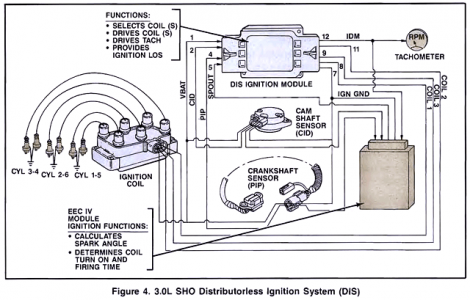

Thanks for the chart. That's helpful!
Yeah, DIS is pretty easy to change out first and test. PCM is, too. I'll start with one of those and see how it goes.

Something as simple as a bad PCM ground could cause problems too. The immediate zero reading on the tach makes me think it is the cam sensor. The cam sensor is supposed to only sync the spark and drive the tach, but the same symptom of the engine cutting out has been documented on the forum, and it is actually the cheapest part to replace with new. A 25 year old cam seal past 100k lets the hall effect sensor get oily inside.
A wiring diagram of the same pic above is in this post: http://shoforum.com/index.php?threads/bad-voltage-at-the-coil-pack.124007/#post-1372824
