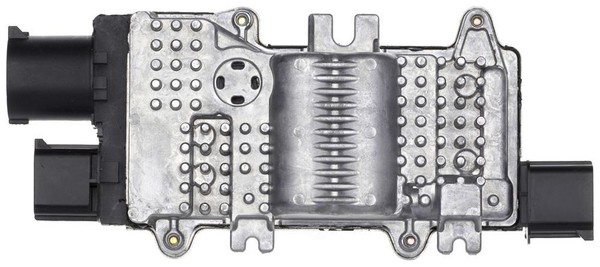

I finally have found the issue with my over heating. Today as I watched temps rise I was able to pull over and see the fans were not on. I suspected this all along but they some how I could never catch them in the act. However I can’t seem to find a fan and module for a 2010 Sho. Any one have a link to one that’s in stock?

I assume you are talking about the Fan Motor Relay (AA8Z-8B658-B)? If so, it looks like it has been discontinued and you have to buy the fan assembly to get it.
