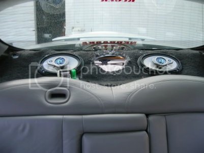

Thread Hi-jack. If there is enough room you can mount them from the top. I punched holes into the factory metal and mounted the speaker on the ring that held the metal for the speaker cover. It worked out good. Those are 6x9's in 5x7 (6x8???) openings.
RearDeck
Not sure if there is enough room under the carpet like a Gen III. I kind of lurk in Gen II audio threads b/c of the lack of audio expandability like the Gen I/II.
Good luck :thumb:
