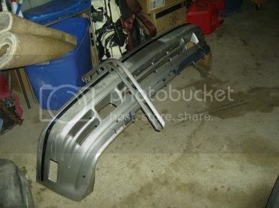

Here's my before:
HPIM0651

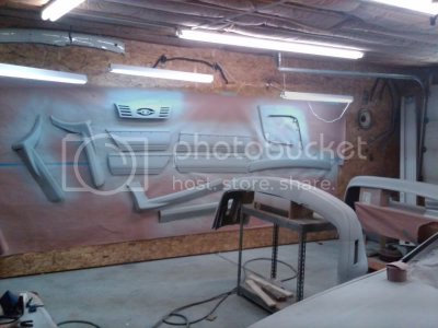

During
IMG00138 20110605 1202

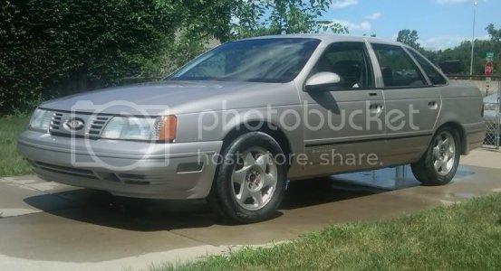

and after
Assembled mostly2

Nice, really nice.
The car looks great, even without the body cladding.
The grille adds alot, it seems to compliment the horizontal lines on the lower part of the bumper.
