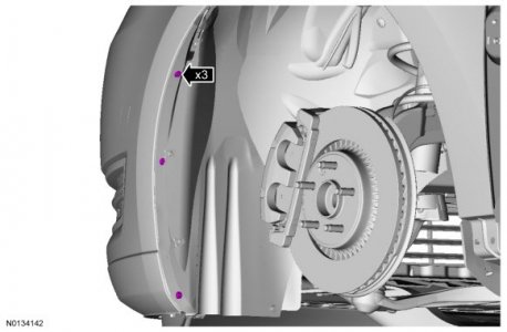

ohh geez not really anything I recall. around the wheel fender a screw and clip - the screw stripped, otherwise the rest were all pretty easy.

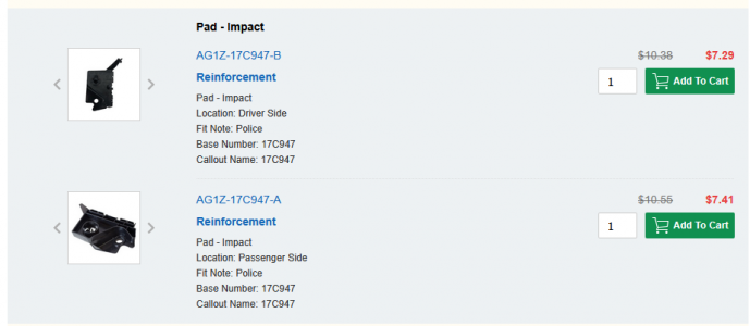

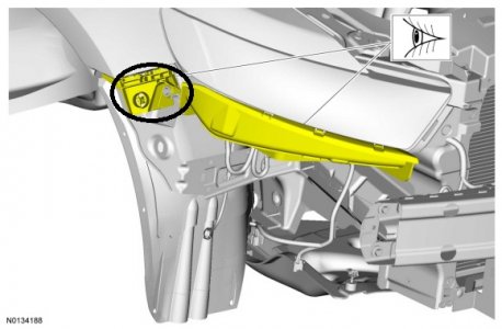

You want to be sure the pieces that clip the bumper cover to the fender, the seam behind the headlight, are not broken and will secure the cover tightly. The parts are cheap.
1755654894980
Ignore the Police fitment. All Taurus are the same.
