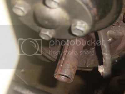

thats the problem my crank is stripped. either way the crank is nice and it came with bearings.So guess i'am pulling my pistons as well to match the new crank? or would my better option just to have the old crank machined, and use the new crank for the other engine i have on the way to rebiuld anyways?
A pic of my crank in the car atm
DSC01196
