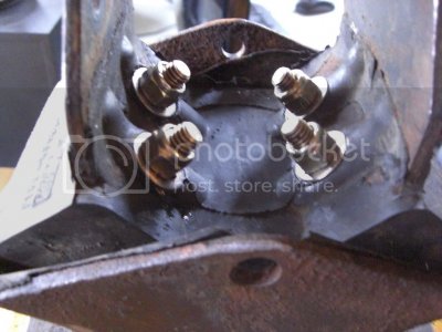

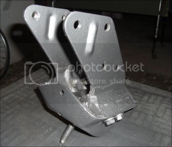

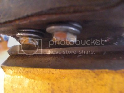

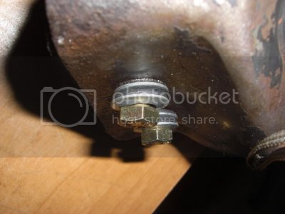

Inspired by another member here, I decided to take an old mount and make it a little stronger. I removed the limiting pin and drilled the mount in four locations, on the ribs. In an effort to limit NHV, I’m trying these rubber lined washers (stacked x2 on the base and x1 on top) and grade 8 hardware, 5/16”. Loctite will be used once I torque everything down. Let me know what you think! There is always room for improvement. These things seem to fail just as fast as you press the gas pedal down or chirp the tyres.
Basic Design:
CIMG5250
Inside view:
CIMG5249

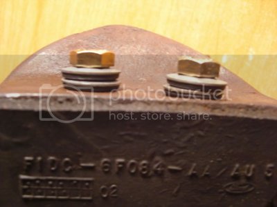

NVH "eliminators"
CIMG5247

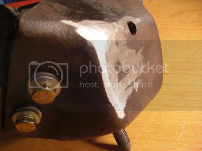

Bye bye limiting bracket and limiting pin:
CIMG5245

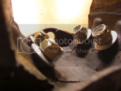

Still brainstorming for options on keep in the washers intact because of the high pressure and torque. Maybe a little JB weld around them to form a retainer or shroud
CIMG5238

Too bad I see a hardware FAIL. :nut:
For those nylon locking nuts to work, the threads of the bolts have to actually be threaded THROUGH the nylon.
Sorry to say, your bolts are coming up short.
As I mentioned, they are not torqued down. The bolts are long enough for the nylon to grab.

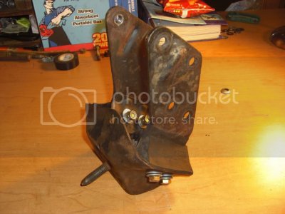

I have tried to shim the mount using a limiting pin, but never the urethane method. Seems like a lot of work and mess plus the jig but the finished product does look impressive. The rubberized washers in this case should reduce NVH. They may also be smashed to peices after a few hundred miles. The mount is fully adjustable but I did use red locktite on the stop nuts. Here is the finished product, will install next week.
CIMG5256
CIMG5255
