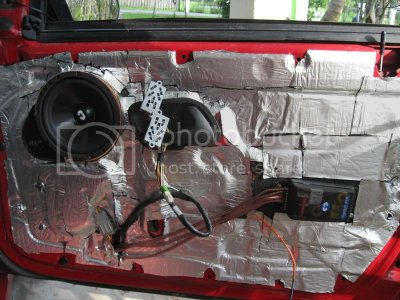

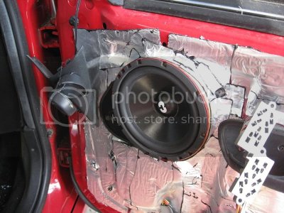

I'd replace the headunit, and at least the front speakers.
When I was shopping for a headunit about two years ago, Kenwood eXelon was high quality stuff for the money. Before that it was Alpine, but they had somewhat gone down hill. I'm not sure what is good now, but you probably won't be very disappointed with anything. Look at the different features available and decide what you want.
As for speakers, I would just replace the fronts and either leave the stock rears or toss them. I have a set of CDT components, but different people like different speakers. Listen to as many different things as you can, and go from there. Whatever you go with, deaden the door panels and much as possible, and seal up the front side of the door and seal the speaker to the door. This will make the biggest difference in sound quality. Here's what my doors looked like in my 95:
Pictures12 23 07016
Pictures12 23 07017
I agree with Toul, don't waste your money on rear speakers. Spend your money on the front speakers, and if you still want more, get some rear speakers for fill. You might also want to upgrade the speaker amps, and maybe a sub and an amp, but that stuff isn't as critical as the headunit and front speakers.

Sorry to thread hijack but what size speaker is that? I had to fab up a speaker ring to put my ID chameleons in, and then I also had to dremel a good bit of the inside of the door panel too. Deep speakers though so no biggy.
K-Dawg
Mar 5, 2003
6,063
1,333
Treasure Coast, FL
It's a 6.5" speaker. Most 6.5" speaker baskets won't fit the stock bracket. I made a spacer ring out of 1/2" MDF. You can barely see it in the picture.
Toul
Apr 20, 2004
375
55
Columbia, SC
I dont think I could even get the majority of my magnet structure through the bracket. That was the biggest pain was the trial and error with limited woodworking tools to build an adapter.
K-Dawg
Mar 5, 2003
6,063
1,333
Treasure Coast, FL
I thought about just building a whole new bracket, but I couldn't figure out a good design that I thought would hold up good over time.
