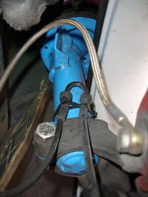

Rear wheel strut gap on 18" (Kris, this one is for you)

Some wanted a pic of this , running on 18x8 38mm offset 245/40/18

So how much room is there on the fender side as I want to put the same wheel offset/tire combination with an 8.5" 18? I will most likely use a spacer with longer studs. Thanks in advance.......
Depends of the offset.
Right, I understand that as I specified my wheel offset as the same (38mm).....I'm asssuming I need to run a 10mm spacer to keep it safe
