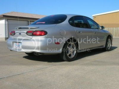

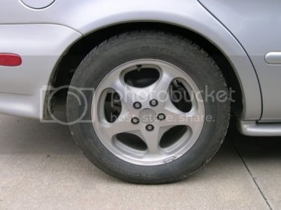

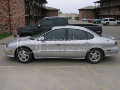

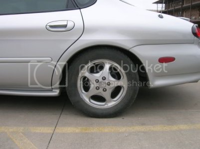

Just started to notice this. Seems like the back half is lower than it probably should be. It has had a slight clunk over rough bumps on the passanger side since I bought it in August, and now sometimes clunks on both sides over bumps instead of just one side. I looked at it yesterday and it just seems to be way to low.
Whats everyone else think? Heres the pics... and I know, she's dirty right now :frown: Maybe it's just the parking lot or something who knows.

redpsycho3 said:
that'd be your shocks, specially with that clunking sound...
Shocks? Struts.
The rear springs of all Taurus' tend to have problems with sagging. That's why when some people install lowering springs all the way around their back end sometimes actually gets raised!
You just have to do like I did and make the front match the rear! ;)

thought in fwd it was struts up front, shocks in back, iunno, i just call em all shocks/struts...

Yea I guess it'd look better lowered in the front. I'm going to have to lift it up in class and look under it. Something just isn't doing it's job. This is the first wrong thing (probably of many to come) that has caught my attention in the 9 months I've had it.
New struts are about 160 each or so I found. 99's also don't have SARC so maybe that will make them cheaper. gulp!:rofl:
EDIT: Yesterday I thought maybe it was my laundry and everything else I had taken home, and then I hoped it was my subs!

Oh boy ROUSCH springs huh!!! Geez and I want them bad too... good thing I'm going back to work as soon as school gets out so I can hopefully get those and exhaust done ASAP.
Looked at my car more and it sits pretty level now... must have been the parking lot, whew. Going to put it on the lift and check out if anythings loose which would result in that d*mned clunking. Front passanger side clunks too... I always thought it was the subframe bushings but somebody else said rod end link things or something.

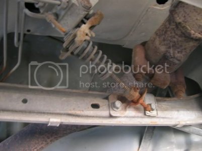

There was one thing I couldnt figure out what it was for though, here's a pic:
NikonPhotos054
Drivers side... seems to pushing onto a sensor or something. Loose as **** though I couldnt figure out if was supposed to be secured or to just move so freely.
NikonPhotos054
Sure looks nicer though after a car wash and cleanin up the tires and wheels!
NikonPhotos055
That's the brake proportioning valve. It will seem a little loose under a no load condition.
