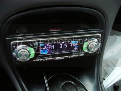

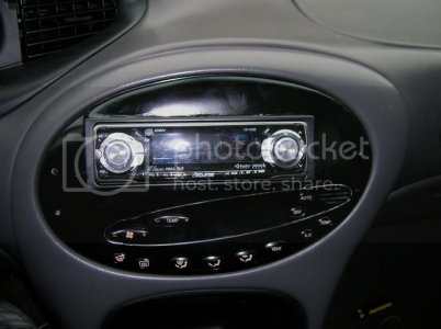

This is what I did before I put it infront of the shifter. Heater didn't work but it looked just about right. I think only one person has been able to get his heater to work after trying to do this as well. I don't remember his name though.
Eclipseradio

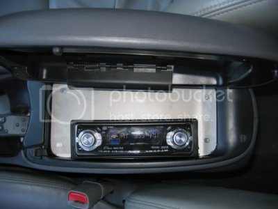

... and before that it was in the console. To dangerous to change settings and try to drive.
Console 5
I'm writing a CNC program to cut a piece of plastic so that space above where my radio sits now is filled. I found a font that looks like the SHO on our bumpers.
