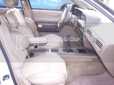

here is an interior pic:

Looks great! Are those full leather seats or split? It's kind of hard to tell with the brightness. Either way, very clean!

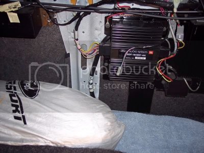

Audio Problem w/ Pictures
Ashley they a split seats
But upon further inspection I found (2) (gray)plugs in not connected but cannot find anything to plug into, there is also a larger white plug in that goes no where
All (3) are in the trunk near the amps? Any help electrical is not my strong pointDD029

not to sound stupid, but did you check the FADE?
I'm assuming the speakers are the stock originals?
Also, I know you said RH side, have you confirmed it is the same for both front and rear speakers on the RH side?

Those 2 gray plugs look just like the speaker plugs - you do have rear speakers in right?
They could possibly go the the subwoofer, but in that case, there would only be one

I checked fade & the speakers are hooked up.
They do work the LH is fine but when I balance to the right side it looses about 70% volume as if the amp for the RH side is broken

BTW my factory sub amp doesn't look like yours. Its silver and in the same position as the Gen II sub amp. (under the keyless entry control on the left) I'm sure its all the same stuff I just like pointing out the subtle nuances in bone stock SHO's. Even Ford couldn't builds cars to original Ford specs. lol.
