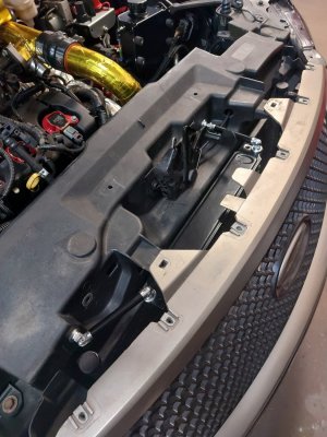

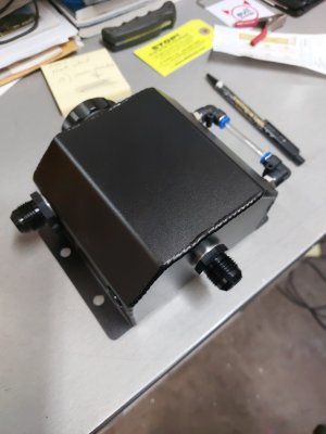

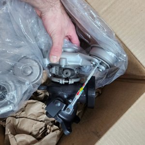

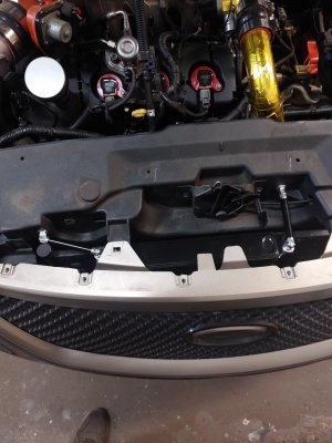

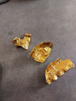

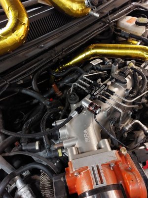

These are all visual examples of what can be done to help cooling
added to the list
-hood vents

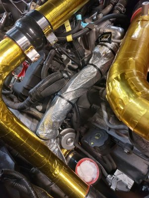

@Vestin112 thanks for sharing those photos. It looks very clean, I have been noodling on adding and oil cooler myself. I always get uptight about electrical work, adding new in cabin sensor guages. Just seem to be so much labor. Nice job wrapping the pipes something I will be seriously considering.

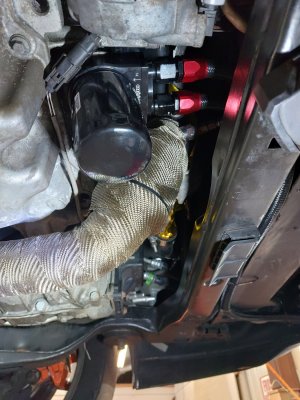

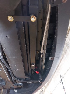

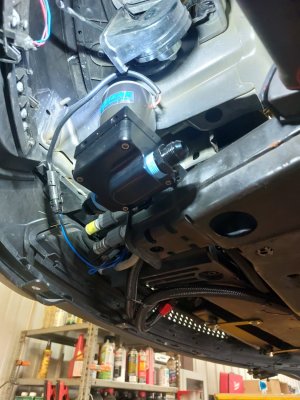

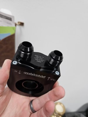

Mind sharing the part numbers you received for your oil cooler? Thread etc, I saw the 185 temp option. Thanks! I think u sold me, where did you mount the air cooler?
The oil cooler sandwich adapter was from Improved racing and it was ENV-131-T4 ordered with a M22x1.5 Thread it was 270 with shipping which was fast as well. It feeds 10 AN connections and for the radiator I used a Mishimoto
about 350 so add in some 10 an fittings and some braided line for about 140 bucks and you're golden. Mounted the cooler right to the bottom of the stack behind the condenser. Mounting bolts went in nice and easy.

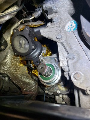

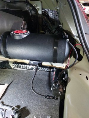

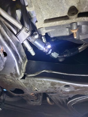

Sweet - thanks!!! I have a PP car. the oil cooler seems like a no brainer to cut down on heat in the radiator/thus engine.
You'll want to delete the old pp oil cooler by getting the oil supply mount from a non PP car as well as a radiator hose from a non pp car and close off the returns on the radiator otherwise I don't know the adapter will work or maybe you can get away with it running both. I also setup the PTU with it's own cooler and pump to alleviate cooling load on the trans cooler.
