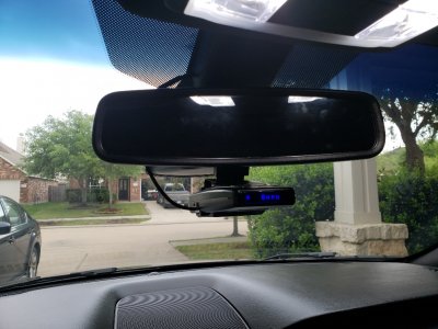

I have a rear view mirror mount for my ****** and tapped into the mirror plug. It's not constant on but I also don't leave it up when I'm out of the car. It gets put away, no need to give anyone an excuse to break in.

I have a Beltronics radar detector and hard power cord and was able to tap into the moonroof power by removing the small upper compartment console and routing the wire behind the camera housing on the windshield. I used a splice adapter so no cutting of wires were needed. I also routed the control wire under the edge of the headliner close to the windshield and down the a-pillar and mounted the mute button on the side of thw center console. The power is key on so no worries about running your battery low and also doesn't turn on when remote start is enabled until you enter the vehicle and press start.

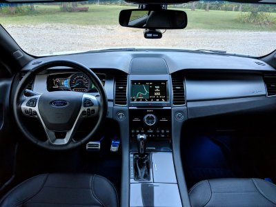

I used a fuse tap and a blend mount for mine.
N2ONyxj
That looks really nice.
A76d48e679afa9eca825c13e7da6ce0f
Didn’t know if a blend mount would allow the detector to see beneath this. Which I’m not even sure what exactly it’s covering to be honest.
