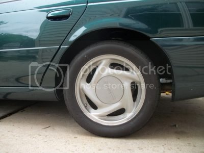

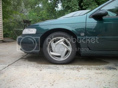

Paul, I've got Sensatrack Quickstruts and when installed (front) I swapped out the TRW spring for an Eibach w/1 coil cut.
CPDPraisetheLardFall2011024
PS: I like the gap I have currently cause it permits easier jacking. Others, lower will need to drive onto something to lift the car up enough to fit a jack.
CPDPraisetheLardFall2011026
Due to a misunderstanding the rear got the dropped strut tower treatment instead of the rear Eibach's w/1 coil cut. Problem is I can no longer fit the 17" wheels on the back because the perch is too low. Don't cut the tabs if you want to fit bigger wheels.

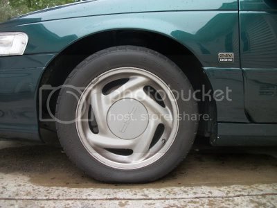

Front:
CPDPraisetheLardFall2011028

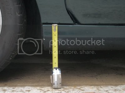

Back:
CPDPraisetheLardFall2011029

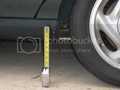

It rides and corners great, not too stiff to be uncomfortable on the highway or commuting in Chicago, but capable of being pushed hard at BIR last summer.
I also added Ingalls adjustable rear arms/H-brace/24/26 bars and all new bushings with some pretty good Kuhmo tires. a few years ago I was struggling to keep up with guys I was driving away from last summer.
DVP has some good threads regarding other spring/coil cut combinations worth looking into. I have settled on taking everything apart and reassembling with Eibach's, 1 coil cut, and then try to get the car balanced front to back while still clearing a 17" cobra replica, so to summerize, one coil cut on all four corners. Good luck with your's.:wave:

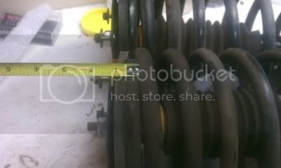

The 89 got svt thunderbird 5 spoke..and it sit really high and got too much gap...just looking to low it 1" perhaps 2", been wondering if someone did done cut the so called TRW springs(which I just learnt from you that its TRW brand)... yes It got about 2-3 dead coil up top...I cud try or maybe it would be better just to ditch it and get moog, Bg or eibach if im lucky to find one.
The '94blk/wht got Moog/sensatrac set up with 3 coil cut up front and 2 in back and it sit quite low...love it. Thanks for your input!
7,521
iirc, the quickstrut springs are similar to the stock springs in that if you cut them you will have them not fit on the perch correctly.

Yesterday, dropped subframe and took qkstrut off...took closer look to see if got some dead coil...found only one coil worth and as Rubydist mentioned that if cut, wont sit on perch right... I am inclined to believe rubydist on this one. The second coil below first coil literally is bigger. If I was to cut one coil it will just net me at least 3/4" drop, pssh not much to do with it! Gonna toss the TRW springs for something better.
