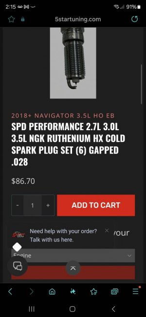

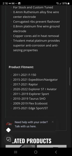

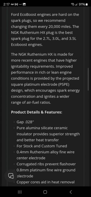

What do you think of this, from what sct claims? ima do more research on these plugs out of curiosity cause i know theyre new, figured id just show you what i just seen after i replied to you while googling.

I'm on my fourth set of GH supplied spark plugs. I checked the gap on the old and new plugs each time I changed them. Total wear on all plugs was LESS than .003" on any plug for the life of my car. I changed the stock plugs along with the tune at 17k, and that set was changed at 40k miles. The last set was changed at 93k miles. All plugs removed from my car since new looked excellent, and I never had a misfire issue. The gap at installation each time was .026", and not one plug removed ever had a gap more than .029". All removed plugs were clean and didn't really need to be changed. At 107,000 miles, my car still runs like new, and I attribute that to religious oil changes and careful maintenance. This engine really does not eat plugs. I would use the GH supplied plugs in my SHO and put the NGK's in your truck.

@Ecobeast2013 this is the word from one of the most reliable sources here in these forums. Suffice to say his background is unchallengeable. I believe I added to my comments, the Ford plugs and coil packs are the best, and even with my last message just yesterday from my tuner Brad, and I quote:
I like where your fuel trims and spark tuning are.
He has never seen any recorded misfires, or spark related issues ever. I am running the XDI and we are putting the finishing touches on her running 93. I am tapped out on turbo boost, but for stock turbos its to be expected. Not to put a finer point on this, stay with the GH plugs, period.
