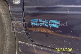

Pinstriping, $1.20
BluiesPinstriping002
dpsutphin
Oct 26, 2005
315
Fort Worth Texas
I just used a cheap paint pen from wal mart. Was much easier than the spray and mask stuff (been there and done that), and still looks good over a year later.
Don't know much about the vinyl decal stuff, but pin striping, as shown by platoribs, would work great if you have the patients and steady hands to do it. I have a custom pin striping job on mine (on the body, not the emblems) that is over 2 years old and still looks like new.
