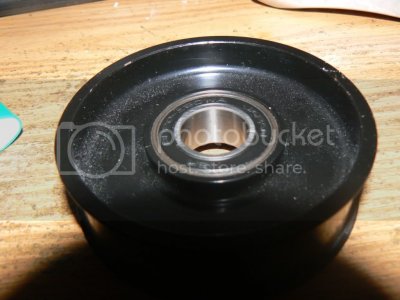

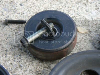

Well, the one I gave you the # for what that "pressed in" 2 peice job on the alternator idler.. and from what I remember I thought both of those bearings were the same. I was able to pick the seals on mine, and repack em... Let me find my camera and I'll get a pic of the bearing ..
P1070756
P1070755
Od roughly ---> 1 + 3/16"
ID Roughly --> 13/16"
Hope that helps.

Much appreciated. I did some more research and it looks like there is not a bearing on the p/s pulley as its one piece. The bearing there is on the pump itself. GREAT! Wonder if thats replaceable or do I have to get another pump all together? I'm hoping its one of the installed idlers from Doug and the part number you gave me will be sufficient. Now just gotta get time to fool with it again.

Thanks for the pics Eric. But they don't look like the ones Doug added to my car. I don't have a pic handy of mine off the car or in the car but they resemble the pulleys off the 4.6/5.4 V-8 Mustang/truck motors as the belt rides on the pulley with no raised side to keep the belt aligned like the one you have pictured. Come to think of it, I think the pulleys look like the SHOs tensioner pulley. Smooth with a rounded side. But, the bearing number may still be the same. I have my fingers crossed. :p

LoL gimme a few and I'll stick my camera under the hood and see if I can get a shot of the other pulley.. ;)

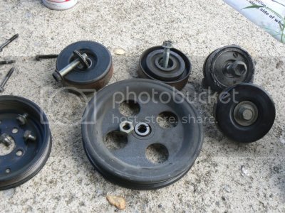

Edit: Can't get the camera in there... let me go and see if I can find a pic in 14 gigs' of pics... ;)
Edit Edit: Here are some ATX pulleys now off a gen 2... MTX's are different... ;) how about these?
P1060922
P1060921
P1060923
I'm betting your talkin about that top one.... that came off the idler I'm %85 sure.. I'm not an atx guy.. lol I think that middle pic was all of em.. unless Bubba or Boat stole one.. lol needed one, used one, whatever.. ;)

The PS pump has a bearing in the back of it that is changable. But that probably is not the problem. The '96-'97 idler pulleys had the raised edge, the '98-'99s did not. You can use either and infact you can use the Gen 3 ones on the V6 SHO motor.
The actual bearing is the same one on the V6 as it is the V8. Proprietary and only SHOnut has them that I am aware of. There are other bearings that can be interchanged as was posted over on TCCA.

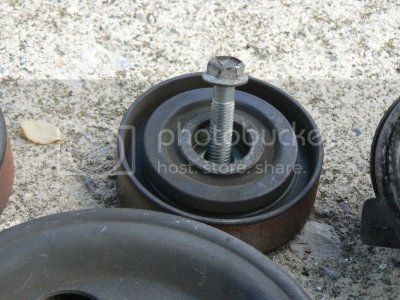

Yeah, I'm pretty sure its the top one too. Is that the one the bearings are readily available or do I need to go and start cussing now?? Here are the two pulleys in question. I'm assuming Paul is right and that I hightly doubt its the p/s pump too, but my luck it will be. These two idlers are what had to be installed to make the belt fit with the blower and such. And boy are they a pain to wrap the belt around; I can only imagine how much cussing I'll do getting the whole thing unbolted and removed from the motor.
