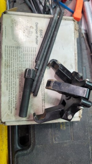

This is what mine looks like, I've used it too many time to count and haven't had any issues getting a crank pully off including the na 3.5 ,3.7 transverse or longitudinal mounted turbo 3.5 and the 5.0 coyote v8

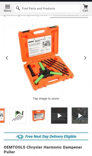

That looks just like the one I'm about to try next. I appreciate it. I just put in Gear head turbos and intercooler a couple months ago and only got to drive my car for about a week before noticing the failing water pump symptoms, and it's been sitting in my buddy's garage since then. I'm itching to get it back on the road now.
