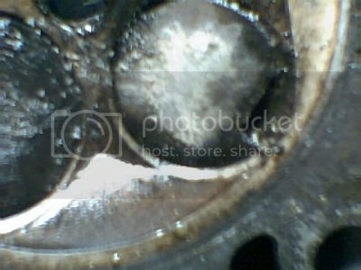

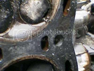

Before I start, I give many apologies and many thanks to the guys who offered to help me out with a DIS but I had the car towed on home anyways. DIS tested bad before this little incident and I replaced it a couple days prior.
Car ran perfect, 94 ATX bone stock. Driving down interstate at 70mph, engine lurches, slight power loss, once I get off the interstate I have a steady miss. Got it home finally and check compression. Front Bank: 190-190-188 Rear bank: 192-0-190-- Check bad cylinder again w/ oil same result, so today I pulled the head(s) off. Attached is a pic of what I found on the bad cylinder, now I have seen burnt valves, cracked seats, lightly cracked valves around edges but never an ENTIRE CHUNK missing... amazing enough the cylinder was not damaged, bore still has cross-hatching so I am sure that this chunk of metal is just lying in wait in the exhaust so I will be sure to blow out the cats and such... but how does this happen??

Running lean and detonation. Or the valve spring broke.

strange... the car ran with a stuck thermostat for a couple of months before I bought it (changed it and blew out converters as soon as I got it) thought it would have been running rich -- also had absolutely no codes prior to this either...the PO also used quaker state and there is about a 1/2 inch of sludge and gum all over the heads....

Sludge won't cause that unless the valve was glued to the seat by it. Nor will it affect compression ratios but carbon will. It appears to have an A/F ratio problem causing that cylinder to run too hot. Look at the valve where it's white. Probably heated it up way beyond tolerance around the edges and cause it to cracked.
Lean fuel ratios cause high exhaust temps and if his thermostat was stuck open, he was running with too much gas in the system. The cats took a dump because of it and so did this exhaust valve.
For the record, running lean means less air for the given amount of fuel. There's unburnt fuel leftover from the combustion process and it ends up burning in the exhaust.
Wikipedia definition:
Lean mixtures improve the fuel economy but also cause sharp rises in the amount of nitrogen oxides (NOX). If the mixture becomes too lean, the engine may fail to ignite, causing misfire and a large increase in unburned hydrocarbon (HC) emissions. Lean mixtures burn hotter and may cause rough idle, hard starting and stalling, and can even damage the catalytic converter, or burn valves in the engine. The risk of spark knock/engine knocking (detonation) is also increased when the engine is under load.

Ran too rich for too long, the cats overheated, crumbled parts of the cats sucked back into the engine on a downshift. IMHO.

It is possible the valve stuck and the piston lightly tapped it - enough to break off a chunk.
