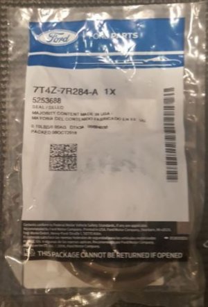

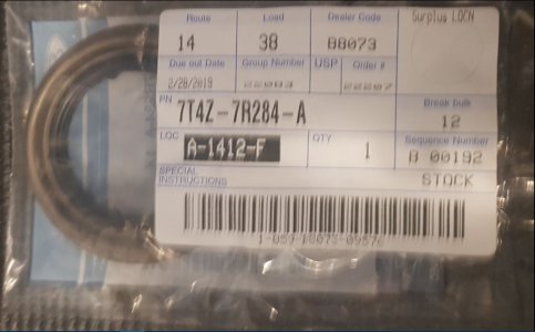

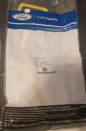

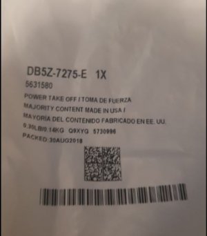

Last Friday got the seals replaced, went ahead and replaced both as it made sense to do so. Parts were about $80 CAD and $190 CAD in labor including replacing the oil in the PTU and sway bar links (could have done it myself but got lazy).
I work about 30 min from home in a small town with about 25,000 people. There is a Ford dealership there, went thinking I would have to order the parts and to my surprise they had them in stock... guy said it was because these parts are common among various models but realistically it is because they fail often.
So far so good, no oil in my garage.
Thanks again to those who helped.
Here are pics of the parts:
46573025175 a8351c13ec o 46573023975 707685c97a o 46573024145 c73891e3ee o 46573024855 1326e836e8 o
