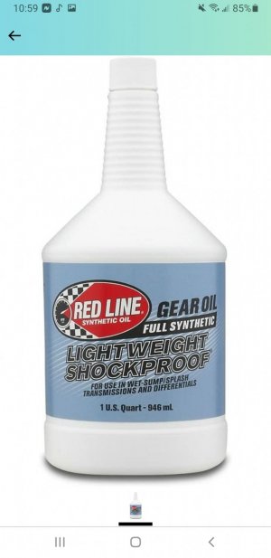

13 sho with PP, just want to make sure I get correct fluid and quality fluid. Is this the stuff I keep hearing about or is there a better option?

I like the Amsoil 75-140 severe gear oil.
Thanks for the recommendation. Looks like $40 on Amazon, they must be proud of that stuff! All jokes aside, any specific reason this is your go to? Just want to get as much info into these things I can.

You can get it much cheaper than that. The main reason I use it is you can get it in a squeezable bag. Just stick a 12" hose on the end of the bag nozzle and squeeze it in. Royal Purple and Redline are good for draining your bank account if that's what you're after.
All synthetic PTU oil is going to hold up about the same which is not well at all. It's cooked by the cat running right along side of it and replacing it often is the best thing to do. I'd run Wally World oil and swap it out every 5,000 miles before I'd buy Royal Purple or Redline swapped out at 10,000 miles.
