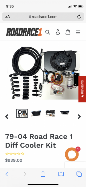

I’m looking for honest thiughts and opinions on whether or not using a Mustang Cobra IRS rear diff cooler kit would be a possible cure for the overheating PTU issues. It would also help in oil drain and fills. Thanks in advance for your thoughts

It would be cheaper to wrap the downpipes in heat wrap and just buy a mighty vac and change the fluid with every other oil change. It would be cool to have that cooler and pump installed though.

Ok, I wasn’t aware of the fill being partially blocked on a PP SHO. As far as getting that cooler kit hooked up and working I don’t see any reason why it couldn’t work. Sorry for the confusion on access to the drain.

Thinking the cooler pump would make it easy to pump the fluid out and pump it back in
Yup, I’d try to mount the pump as low as possible to be gravity fed. Interested to see how you’ll mount the cooler. I think it’s definitely pretty cool and a nice setup. Have you tried piecing what you’d need separately, wondering if it’s necessary to purchase that Mustang cobra specific kit, or if buying the pump, cooler, and some lines separately would cut cost down some. Maybe in the $600 range. Just a thought.
The picture was there to show people what I was referring to however I haven’t priced it out as of yet. Still in the thought stage at this point.

I do not have any experience with this topic but, my personal question would be, what viscosity is the cooler/pump designed to handle? Our differential uses 80-90 (Mustang uses 75-85). The PTU uses 75-140. Is this an issue?

With a tilton pump it is not an issue with the viscosity. I’m sure it’s not with most pumps designed for differential coolers

Some of us don’t have an hour to spend filling it through the vent tube or would rather spend that time doing something else. Just looking at other oprions and this option has the added benefit of cooling and prolonging the lifespan of the ptu

The PP PTU's are already liquid cooled. Your best bet is to wrap the downpipes with heat wrap/ceramic coat, put in a good fluid and change it annually. If you want to add the cooler by all means. I just don't see it making a dramatic temp change. Most PTU temps stay around what the engine coolant temp is, and adding the cooler is just another system that can fail.

Yeah, I'm with SM105K on this one. Save your money and the aggravation. I've just turned 110K on mine and had it changed once. It wasn't all burnt to a crisp, just a little thick, and I pound on it occasionally.

This isn't going to work, you're going to have all kinds if issues trying to maintain the proper level inside the PTU.
A few issues. The PTU is a vented case, not filled to capacity as there is a void in there. It is also not designed to see any sort of pressure or you'll push oil passed the seals.
In the system you are thinking of, as the oil passes through the cooler, it will become less viscous, not much, but enough to create a "backup" and it will spill out the vent.
If the system was a closed, non-vented system with the ability to take pressures, or in a system that has way more capacity and "reserve" empty space, this could work, but I foresee a ton of oil spewing from the vent....

All rear differential’s are vented as well. However depending on the pressure the seals could be an issue
