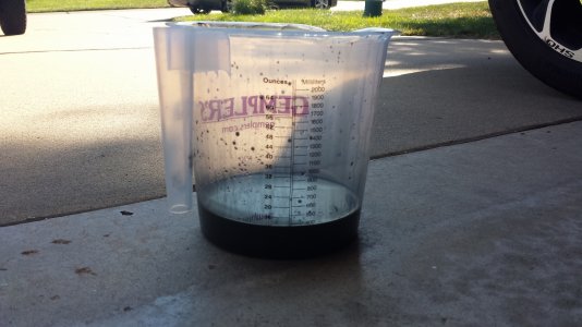

If it's Pundman Ford in St Charles, they're pretty solid and Ford does call the PTU fluid as lifetime but that's just wishful thinking. In my experience, the PP cars probably fair better than non PP as when I changed mine at 50K+ it still looked decent. Changing it out is never going to hurt anything and if nothing else, maybe see if they can save part of your sample or ask in advance if they can give you a opinion on the fluid they drain in advance of them performing the work so the tech can note it. If they note that it looked like it was thick or forming sludge, had metal in it, etc it can give you an idea on what to expect in the future. Below is a pic on what came out of mine on the 50k+ change-dark but still thin, no metal to speak of on the drain magnet, and no burnt odor. I was able to reclaim 12oz with the car tilted on jack stands, spec from Ford PTS is 18oz and I have no leaks so I still had 6oz trapped, most likely in the cooler system of the PP)
From ford PTS factory on line manual- (This is what the dealers refer to when they say it's not required)
NOTICE: Install a new PTU any time the PTU has been submerged in water.
NOTE: Do not drain the PTU unless contamination is suspected. The fluid that is drained may appear black and have a pungent odor. Do not mistake this for contaminated fluid.
NOTE: Fill level checks are done in-vehicle only. Let the vehicle sit 10 minutes after the road test before checking the fluid level.
All vehicles
PTU20Drain20120 2
