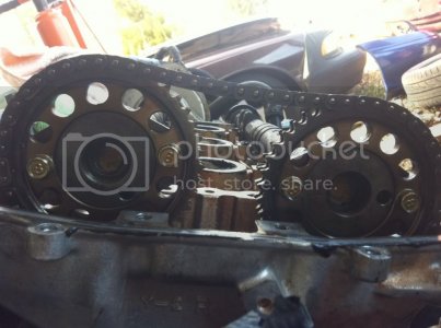

These are how the cams sit right now. Im not to sure SHOshop made the stage 2's out of 3.0 cams cause the intake cam will not line up with the hole in the cam. The exhaust cam does line up with the hole in the cam. I pulled the other valve cover and noticed the car did have 3.0 cams and all the dots and holes lined up perfectly. Also on the stage 2's intake cam it is not a KOA cam. I think it said m12 or something.

Thats looks like a 3.2 / ATX intake cam to me , still a tooth off. The bolts should be staight across on either the 3.0 /MTX or 3.2 / ATX,
43f66b2d
The 3.2 /ATX intake cam on the other head should ALMOST line up, ( bolt and cam hole ) but still will be a little off when properly installed BUT the bolts should ALWAYS be staight across from each other on ALL set ups

these are SHOshop stage 2 cams. I have confirmed one cam is a ATX cam. The reason it looks a tooth off is because the ATX cam is advanced 4 degrees (according to Mr.A) But if you look closely the white chain mark is on the gears dimple.

One ATX and one MTX intake cam core in same engine? I would get out the mic and start measuring all 4 cams to see if they are even matched in lift numbers.
My understanding is the ATX "advance" was ground into the lobes and when installed they still lined with the bolt all in a line, ( this is reguardless if its MTX or ATX )
I run the sho nut +20 cams ground on atx cores and installed them as per factory (ATX / MTX with all the bolts aligned) and it runs great.

You're still at least a tooth off. The bolts should line up regardless.

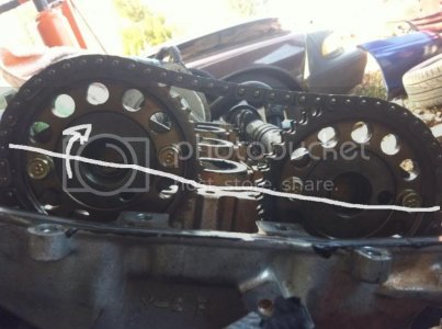

You have an ATX cam there and it is on backwards. The hole needs to be on the other side.
See here in the picture:
Do you have a picture of the cam bearing surfaces?
