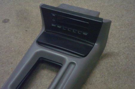

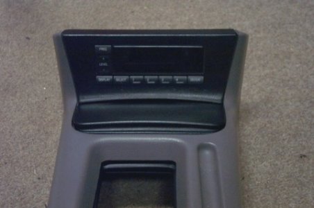

just finished up my lastest project, installing a probe eq in the 93. i've had the idea bouncing around since i saw one waaaaay back in 2000 but could never find one and pretty much gave up on the idea. then i saw jelloslug's install and i knew i just had to have one as well. i wanted it to look like it was factory so i decided to "infuse" the probe faceplate into the front of the console. let me know what you think. for anyone considering it it really does make the jbl sound better. can't wait to have it completely installed in the car! :cool:

Aaron, very NICE!!!!!!!!!!!!!!!!!!

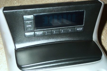

I have a probe EQ too. Does that make me #4?
Edit: here are some pics:
Notice that the lack of ashtray where one would expect to find it. I came across an old Lincoln Continental is a junk yard that had the same centre console as the sho. On the SHO the original tape box and front ashtray are 2 separate components. On the Conti there is no ashtray.

Those both look nice. I'm interested in how they help the sound, too. I may have to do this...
And BTW, ohioshodude, how did you get that to look so good?

plastic epoxy, and lots of sanding. also my secret "textured" paint process. :p pretty much just any textured paint lightly sanded then painted the color you need gives the same effect as stock.
