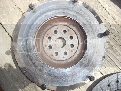

Flywheel
012 2

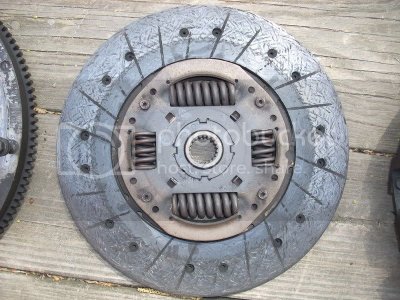

Clutch, flywheel side
013 2

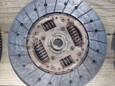

Clutch, pressure plate side
017 2

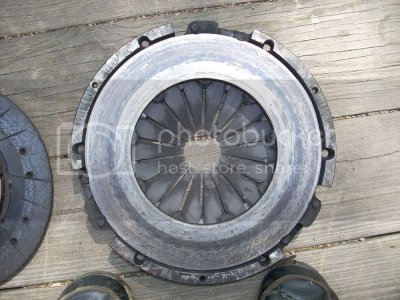

PP
020 2

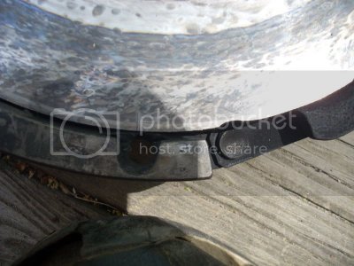

Close-up of one of the cracks... only good pic I got
DSCN0433
What think ye?
