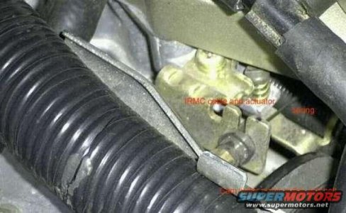

You are looking at the wrong cables. The Throttle has two cables attached, one is the gas pedal the other is the cruise control.
The IRM cable runs from the box under the appearance cover, turns 90 degrees and connects to the IRM butterfly linkage located behind and below the 90 bend after the throttle body. With the appearance cover off you can just see the point of attachment for the cable and the front IRM linkage actuator.
Here is a pic. 434togglefullsizefilenameIRMC actuator cable 2

I finally found the linkage going by your picture and description, and re-did the procedure described in your first post, and the linkage definately did not move.
