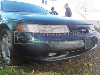

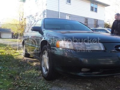

This thread would be worthless without pics, so here we go: (taken w/a camera phone sorry about the quality)
Shobackend94
Shofronteft94
Shofrontbumper94

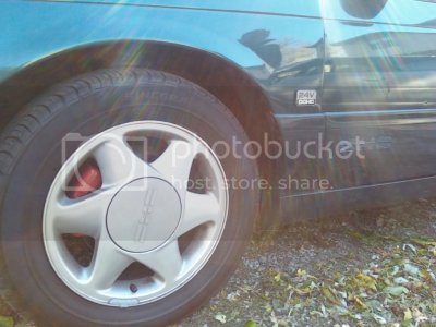

Shorim94

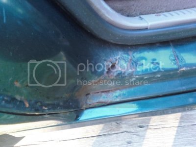

Couple rust areas:
Shorustdoorsil94

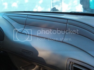

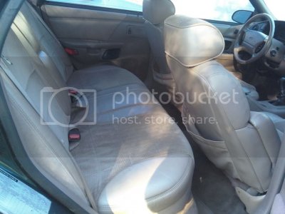

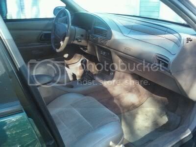

Few Cracks in the dash (EATC buttons are in pretty poor condition)
Shodash94
Shoint94
Shorearseat

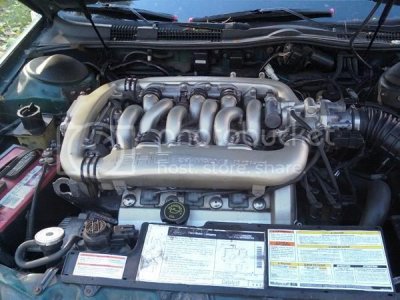

Has a few minor bolt-ons, engine bay looks pretty clean

Looks like a nice average condition SHO. A few things...why was the engine replaced? Did it spin a bearing? These engines tend to run at lower oil pressure, so replacing the rod bearings is good preventative maintenance on the MTX cars. Inquire about this and why the engine was replaced. If it has 146k and the new motor has 90k on it, that means it would have been replaced at only 56k....something went wrong. These motors last beyond that. I doubt it spun a bearing with only 56k...definitely want more info on that.
The temp needle, although odd, is considered fine as long as it's anywhere in the NORMAL wording on the gauge. This doesn't seem right as the N is up there near the H....some of these cars have the needles creep up there. As long as you drove the car for a bit and it stays anywhere within the normal range, you should be ok.
Vibration from the brake pedal? I have no idea.
Does the a/c and heat work? Any noises from the suspension? Tires look decent from the pics.
FWIW, I paid $1900 for a clean, rust free 95 MTX with 144k 2 months ago. See if you can get him down to $2k. IMO, that would be fair.

Looks good, Id try talking him down if I were you. The things I can see wrong is the pass. vent is broken, as you say the EATC button are gone, a new unit around $100. The intake supports are missing and the firewall cover is missing. I might be knit-pickin but for 2500 I would want more. Just my opinion.

What bolt-ons does it have?
I noticed red calipers; are those just painted stockers, or were they upgraded?
No, I appreciate the knit-picking, not knowing exactly what to look for I didn't even realize the missing intake supports or firewall cover, thanks for pointing those out...firewall cover doesn't seem to serious, but what about the intake supports?
It has a magnaflow y-pipe and big bore intake and butterflys, and the brakes are just the stockers unfortunately with newer pads.

I would offer no more than $2000 if your heart is set on it. With green being the most built color and least desirable SHO, especially with rust in those places, that seems fair for the buyer and seller if it indeed has the y pipe with BBBs and the fresher 60k ect claimed.
