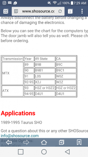

You can use any89-95 non california MTX computer.
B9B
B9B1
LOS
X2J
sperold
Last to Know
Aug 25, 2008
3,753
1,440
Ontario Canada
You can see the XJ2 on the photo you included in post #1.
It is not a part number that you use to order the unit from a supplier, but it is the number that identifies the unit you need, and it is used throughout the trade.
You have the most advanced, most developed software in that unit for a manual shift set up.
To clear things up, when looking at the list above from area91, the model year of the car, when you go down the list is 89, 90, 91, 92 to 95.

Those are the ecus you can use. But the xj2 can b used in all yeras of the mtx. To my knowledge.
