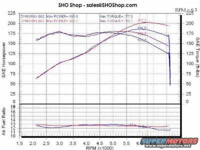

Our little motors are not like a 305 Chev where every little thing you do to them helps them out a lot. They are already at a high state of tune with a lot of matched components that work together to give surprising results.
When Shoshop was still around, I can remember they experimented with their best attempt at a header, and it ended up developing less horsepower than the stock cast iron manifold.
You already have a lot of mods, and if you have found them to have made an improvement, then maybe the intake would work out for you. But I would remember the Shoshop header story and be cautious. I would PM people who have seriously modified their cars and ask which combination of changes gave them good results. Snoop around the forum for these people (Phoenix, OffroadSHO and a host of others) and follow their advice.

The SHO Shop was experimenting with extrude honing. First the intake was extrude hone and tested on the dynojet. Torque went up all across the power band. Next they extrude honed the exhaust manifolds. Torque dropped all across the power band. The consensus at the time for the loss in power had to do with the velocity of the exhaust gases were decreased by the extrude hone process and decreased the scavenging of the exhaust gases from the engine. There were a lot of discussion about fluid dynamics that was over my head that explains this. I have attached a dynosheet from the SHO Shop stock engine before and after for long tube headers and no cats
