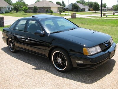

hey i just bought a 91 SHO and was told it had a fiber glass hood on it and i was wondering if ther was any way to tell if it is a SHO plus hood it is not a SHO plus car

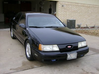

If there is a recessed curve up by the cowl that follows the contour of the edge of the hood ( bout six inches from the edge), its not a plus hood. If the hood is perfectly smooth and has a slight **** in the middle towards the front, its a plus hood.
plus hood

non plus hood
