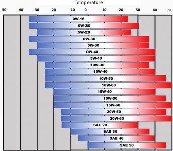

10w30 will help with fuel dilution as it is less likely to drop out of the 5w30 range than 5w30 is. better for the engine.
5w and 10w specs are very similar in the cold. you have to remember, the weights are not fixed, they are ranges.SAE Viscosity Grades including 0W16

5w and 10w specs are very similar in the cold. you have to remember, the weights are not fixed, they are ranges.View attachment 89469
There a billion different opinions on motor oils and I hope this doesn't turn into an oil thread but I feel compelled to add my 2 cents. I rarely second guess the engineers who select the proper oil viscosity. Engine oil is more than just a lubricant, it is used as a hydraulic fluid to run cam phasers, lifters, and chain tensioners, for example. They consider these systems when selecting an oil. They also can select ultra thin oils to improve fuel economy in certain engines (see 0W-16). The only time I select a different viscosity oil is for a tired engine with low oil pressure.
I do, however, absolutely second guess the recommended change intervals. Car manufactures get credit for reducing the carbon footprint of a car and having long change intervals helps achieve this goal. I run full synthetic and change at 5000 miles with normal driving. I believe this has far more impact on engine life than changing the viscosity. Just my 2 cents.
