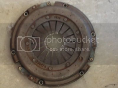

I've gone through 2 stock TOB's. They took out the Pressure plate both times, and the disc still had Plenty of life left. http://www.cardomain.com/ride/2058584
Scroll down do see the first TOB. These are pics of the second one.Joshworkingoncar004
[/IMG]
Trust me....the few extra $$ are worth it. :thumb:
B:cool:
