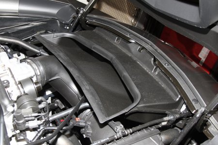

My 13PP has the uncut delta. I can't remember which suv we have in the fleet, but one of them has a removable duct an the lower right side that's open. You can always go NASCAR and start small and see if it makes a difference and enlarge as desired, possibly put a temp probe under the hood and do a highway run with it taped shut then pull the tape and repeat. One of the best designs I've seen to date is the new Corvette-designed to pull air in through the radiator and vent from the top of the hood.
As in like functional engine hood vents...?
Ef903043406f7ee0caeaa7161d1f09c6
D3e766a902c98ce810c0e2923caadca3313737d02c6e375c2cabe1e9090039133ed0b5bcd73bd90828d26b7aea1ab276
xFallenxCripplex
Jul 5, 2016
497
255
Yup, like that but the C7 takes it to a whole different level to pull heat out.
C720hood20duct
That looks like it's just taking heat from the radiator out not the rest of the engine ... I assume that maybe better way of getting a cooler radiator that will make the engine cooler but less dirty.

That would keep the heat that the radiator has just transferred from the engine->coolant->air from being immediately passed back over the engine by forcing it out the top of the hood. Seems like a good idea.
