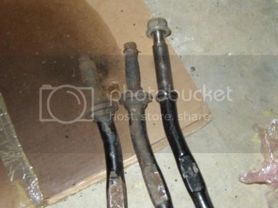

with a rust belt SHO you may want to look into getting a couple spare front strut rods in case the ones you have are pretty rusty under the bushings or you break one when you do the ball joints.

I know what you mean. This is what happened to my front strut rods when I did my balljoints:
P8100007
one is pre getting the rusty parts off, the other is post getting the rusty parts off and the one on the far right is the rust free one I got from SHO Source
