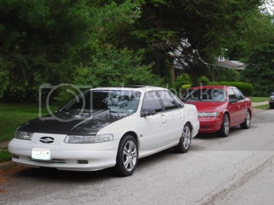

I already had one of James's Loan-a-SHOs
DSC00387 1

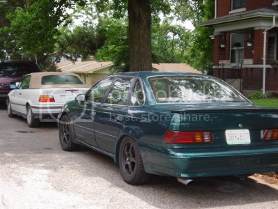

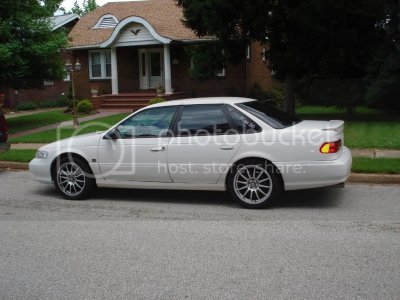

Very soon after Goalieman arrived sporting some new killer wheels
SweetridewithnewShoes

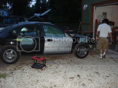

James took a look at the "I Got Rust Mobile"
GotRust

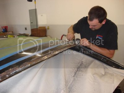

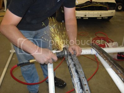

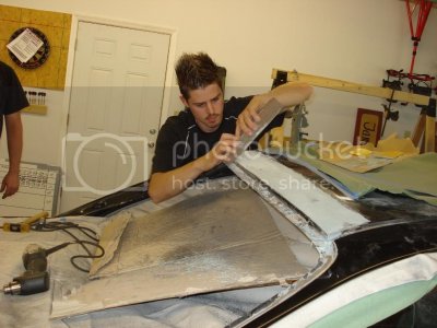

James did some measuring and some test cuts to find the best "slice" as it were
Sizingthenewmetal

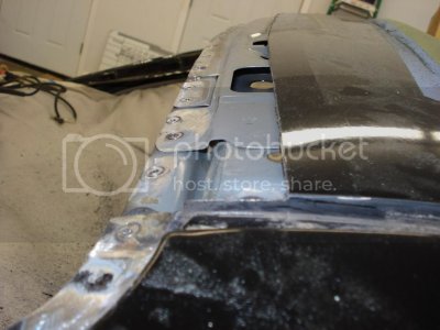

Plan "A" was to cut a larger piece and use a flanging tool to make the repair but the glue and lack of space called for a butt weld so James went to plan "B"
Cuttingouttheold

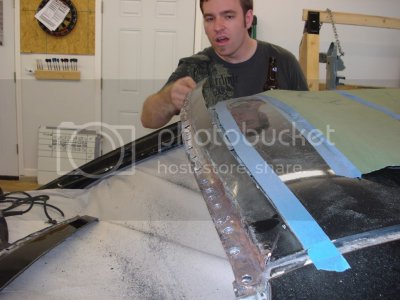

Steve removed the old metal (I'm not really sure what he was thinking here)
Steveremovestherustypart

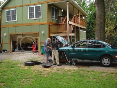

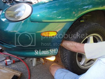

Curt arrived earlier and I began my part, Curt needed a broken sway bar replaced, Aluminum sub-frame bushings installed, sway bar links, other front motor mount, and a replacement left strut.
OthergoingsOn

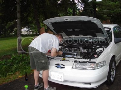

Goalieman worked on some engine detail
DSC00431

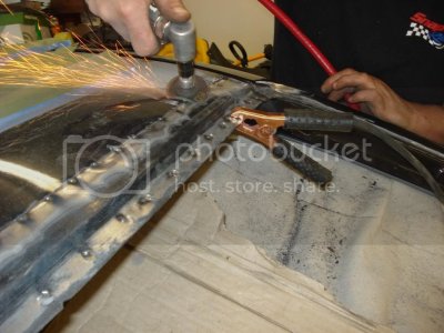

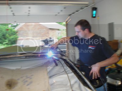

James "tacked the new piece in place"
DSC00482

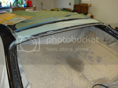

After grinding the welds to test the fit and smoothness, James completed the welding
Checkingthefit2
A thin coat of "plastic" was applied
Thefirstcoat
Shaped
Shaping

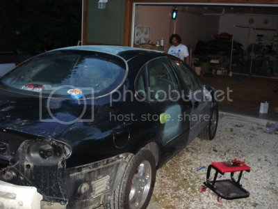

James was just about done while I got some help finishing Curt's car...
Puttingtobacktogether

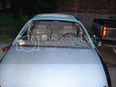

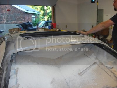

Then James primed his work
PrimerCoat

The car is being sprayed with the windshield, backglass, and channel run moldings removed . . . right ?
