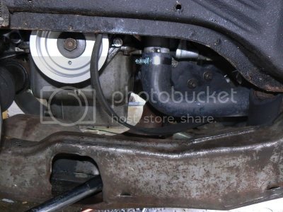

mine are aluminum and a 4 peice set... look nothing like stock.. :)
Here is 2, can't find a shot of the P/S pulley..
P1000721
A shot of my crank pulley..
P1000744
