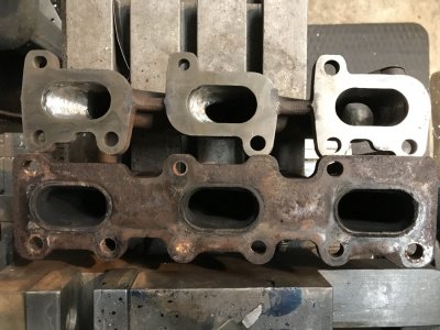

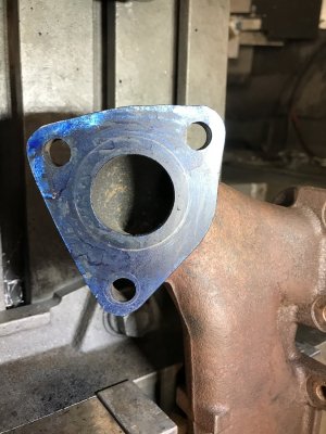

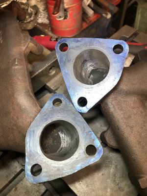

For normal guys like me. I did the +13 manifolds and did alittle porting to them nothing super crazy just some that look ok.
