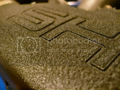

Colors are going to be limited, but Duplicolor wheel paint does fantastic as intake and valve cover paint.
Mine had more than 50k and 6 years on it. No fading, no chips, just look'in good.

That does look good. Is that a recent picture?
