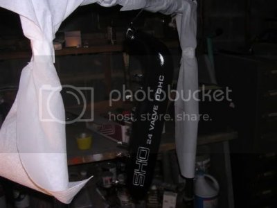

I ended up taping off the letters and dabbing drops of paint into the letters. Took about 6 hours so it wasn't easy.
The reason why I wanted high temp paint is because I wanted the letters to match the runners, valves covers, ect.
DSCN2328
Thanks for all the input. :salute:
