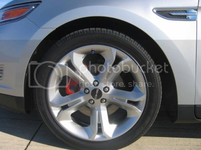

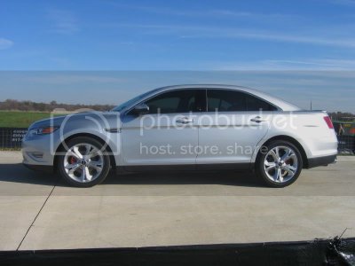

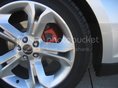

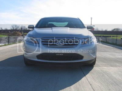

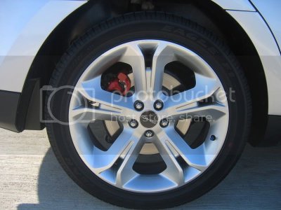

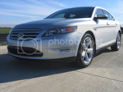

Just wanted to share my 2012 with painted calipers, SHO center caps, & SHO front emblem. I went with red calipers with SHO emblems only on the front. I decided on not tinting my tails. I had tinted tails on my SRT Jeep and was pulled over many times. Anyway, I put a silver metallic SHO emblem on the front bumper that closely matches the body. All emblems were custom made by a very nice eBay seller. The SHO center caps were already available from eBay as well. Opinions are greatly appreciated!

The front SHO decal is not raised. One thing to note, the lower black/dark gray part of the car is very porous. The decal had a hard time sticking. I cleaned the area with IPA before applying it, so I'm hoping it stays put. I don't know how it will do in rain or after several washes.

I used red G2 caliper paint kit. The decals are outdoor rated vinyl. I put the car on stands and removed all four wheels. Removed all rotors, brake pads, and metal guide thingies. Hit each caliper up with some light sand paper then sprayed with the included brake cleaner. Put 2.5 coats on each caliper and let the car sit overnight.
Reinstalled everything the next morning. Before putting the wheels on, I put on the white SHO decals on the front calipers and then sprayed them with a light coat of High Temperature Clear Coat.
