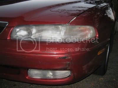

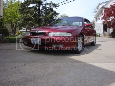

Well doing the prep work yourself will definitely be a plus. But some body shops will refuse to paint a car if they haven't done the prep. Good paint is nothing without good prep. If you can find a good body shop in your area to do the prep and paint id spend the extra cash. For example my friend had a 96 Mazda 626. A woman pulled out in front of him from a side street and he hit her drivers rear quarter. It damaged the hood, bumper, and fender. The car had a bunch of stone chips on the front of it and the fender had a bad wrinkle. The body shop which is Lou Pelosi's Precision Collision in Cranston RI did a great job. They used all the orig panels smoothed everything out and re painted the whole front end. The car looked like new and the paint matched perfect. They did all this for $1500 and he was able to keep $750 bucks in his pocket. Not bad if you ask me.
