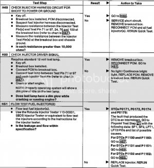

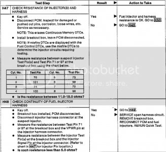

Based on your testing results it sounds like your's is probably okay, but there may still be a wiring problem. I was able to export some of the pin point tests to possibly help...
Ford 96 SHO H47 zpsbhn4xlzj
Ford 96 SHO H49 51 zpssnxuafke

Sorry I gave you the same page twice. I have provided the earlier steps H47-48 which tells you which PIN's on the wiring harness at the computer you need to probe.
You won't have access to a break-out harness so a way to work around that, I usually strip some CAT-5 or CAT-6 wire or anything less than 18 gauge. Then I take the bare wire and wrap it around the PIN's on the fuel injector, then put the connector back on. Be sure to make the wires long enough that you can get to them after you have the connector on. Also make sure they do not touch each other and short themselves out. Now you can run through the tests as noted in the diagrams. Testing for voltage and resistance between the ECU and the Fuel Injector. #6 will be PIN 99 on the ECU.

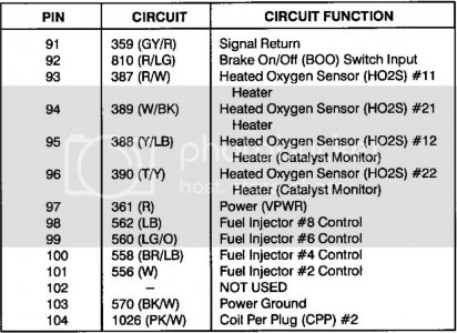

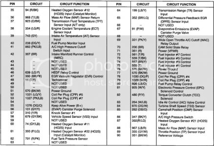

Here is the ECU Connector information for your reference.
Ord 96 SHO C191 PCM20Connector Page 1 zpslth0w7zq
Ord 96 SHO C191 PCM20Connector Page 2 zpsmnxh3xnf
Ord 96 SHO C191 PCM20Connector Page 3 zpss10tigda
