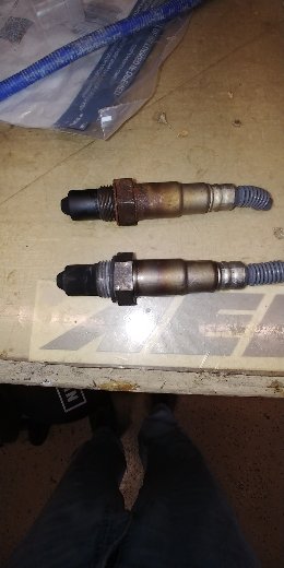

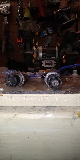

So a successful change of sensors. Bloody and bruised lol. Here's the proof lol.
Now how do I get the code deleted? My scanner says it's a permanent code. Ee16ae42bf65e38dafd6df5f2a2ec23a0ee7e243ffcc110c29227a9114264075
