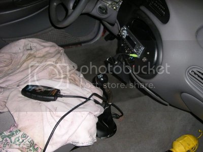

Here's the interior.
Interior002

Other outside the trans things that could cause problems would be shifter alignment. Is there anything interfering with engagement when all 4 wheels are on the ground? And motor mounts. Many people experience shifting issues when they have bad/broken mounts.
Good luck with it! It looks like a cool project! I love the shifter on the floor idea. :thumb:

Yeah, at first I really wasn't sure I would like how it looks, but it's grown on me. The car really wants to be driven; if I can get the shifting fixed, it will be a blast. Good Vulcan (relatively) low range torque plus low SHO gearing sounds like fun to me! It sounds a lot meaner with the SHO pipe and resonator on it too.
